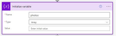

I am able to grab my attachments and place them in an email, I'm sure you could do the same into a folder.
Did you initialize an array variable for your photos?

I have a 'feature attachments' dynamic content option.  This will not appear in the email attachments field, it will only appear as an option when setting up an array because it is can contain multiple values.  You must initialize an array from 'feature attachments'
