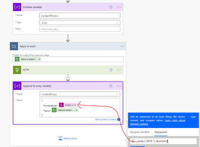

Immediately after your HTTP module, add an Append to array variable action.
  • For the Name, select the variable you initialized at the top of your flow.
  • For the value, you need to carefully enter a JSON string specifying the ContentBytes and unique Name of the attachments.
  • Start by adding this JSON string
  "ContentBytes": <Your HTTP action Body goes here. Build using an Expression>,
  "Name":<Your feature attachments name goes here. Get from Dynamic Content>
  • Now, replace the ContentBytes and Name values as follows:
    • ContentBytes: Use the Expression tab to write the following expression: base64ToBinary (body('HTTP').$content)
    • Name: Use the Dynamic content tab to select the feature attachments name property for the question with your attachments. In my case it was feature attachments photos name.
fow3.gif Make sure you set your JSON value accurately. Do not forget the commas, curly brackets and other things that make JSON be JSON...  Do not forget the comma right after the Body Content!

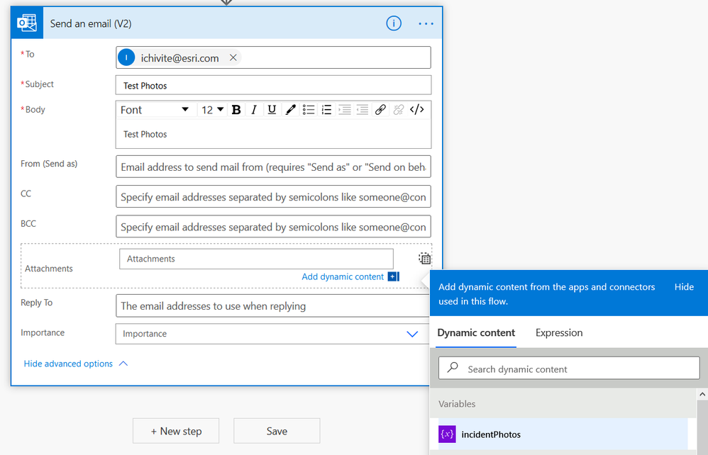

Add a new Step to send an email.
 The key to setting up the Send an email action is to open the Advanced options panel and click the Switch to input entire array icon.
 You will now be able to use the Dynamic content dialog to select the array variable you setup at the beginning of the flow.

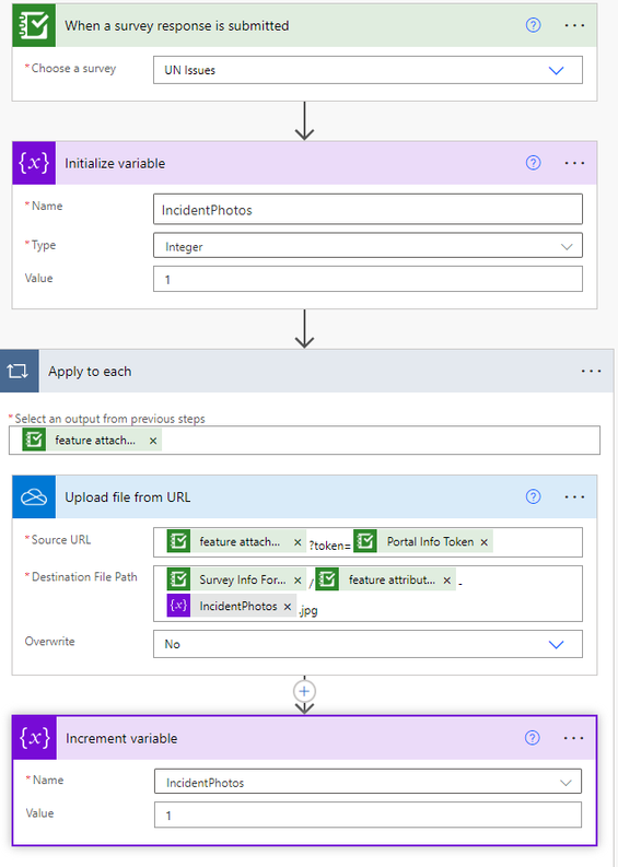

Next we will have a look at another common scenario where you might want to backup your files, or host them outside ArcGIS so they can be used with other third party systems.
If you want to upload your attachments into Microsoft One Drive, for example, you can use the Upload file from URL action. For the Source URL property, select from the Dynamic content dialog the feature attachments URL array for the appropriate question in your survey. Remember that if working against a private survey you will also need to add your token to the url (?token=[Portal Info Token]). An apply to each block will be added automatically for you. Now all you need to do is to select the Destination File Path for your file. You can select an existing folder, or even create a new one.
In the example above, I set the Destination File Path using one of the questions in my survey. The value of my question determines the directory in OneDrive where the file will be stored. If the folder exists, it will use it. Otherwise, it will create a new one. This is an interesting concept, as it helps organizing files nicely: by ZIP
code, by case ID, by field team, etc.

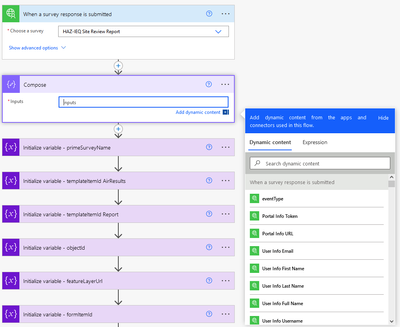

Michael_VanHatten
Hi @abureaux,
Thanks for the quick response. I have my enterprise connection setup correctly and I followed the exact steps you mentioned in your response. My enterprise connection works without issue, and I have all my web hook options enable. The issue I have is the the dynamic content offered to the S123 trigger are not the same as those offered for a survey published through enterprise. I get not features or attribute content and have to make custom expressions to call particular attributes. This means I get no feature.attribute.photo. I know my names will be different but regardless the enterprise trigger does not give you the same list of dynamic content that a normal S123 connection would/ is shown. Something with enterprise connections makes the dynamic content different in PA.
I am thinking I need to write a expression to call the photos, for all my attributes (questions in survey) I wrote expressions to call the data because there are no dynamic content options available. Example triggerBody()?['feature']?['attributes']['facility_name'] gets me the "Facility Name" answers from the survey. For the photos I have to call the related table with the photos and I am not sure how to do that.

Michael_VanHatten
Hi @abureaux
Thanks for the response, unfortunately even after using your suggestion of '=' in the dynamic content I do not get anything for my feature attachments. I have no way to link my photos URL to the HTTP paths or any part of the above mentioned work flow. You say that this workflow should work for enterprise, are you using this with enterprise? It seems to me that AGOL and Enterprise do not have the same support with PA. Almost every workflow I find for survey123 and PA references dynamic content for photos and unique questions in the survey. The enterprise dynamic content has never shown me any of my attributes (unique survey questions) or anything that mentions photos.
I have not dynamic content to fill in these questions in the example
I think I can write expressions to call the photos but I do not know what is being called in the highlighted boxes I do not get any dynamic content like that.
abureaux
MVP Frequent Contributor
The support for PA is identical between AGOL and Enterprise. I use Enterprise exclusively, but I have also worked with AGOL for troubleshooting purposes. The only difference is the connector. I can swap a flow from being an Enterprise flow to an AGOL flow simply by changing the connector from my Custom Connector (Enterprise) to the built-in AGOL connector.
The connector you have in your screen shot looks like the AGOL connector. You can customize Enterprise's Custom Connector within PA, so maybe that is what you did here?
You can confirm which connection you should be using in PA by going to Data (in the left-hand list) > Connections. You will see your Custom Connector in the list (this is mine):
Then, in your flow, you should add this same Custom Connector as the flow's trigger:
I have multiple Custom Connectors for various testing environments, which is why there are multiple options here. If you hover over one though, it gives you the full name.
If you reference that trigger (in my example, I am using a Compose), the dynamic content should be populated by items from your survey:
Does this match what you are doing? If not, where exactly does it break down. Perhaps I am just misunderstanding you.

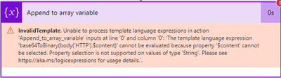

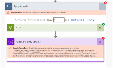

Hi, I am having issues with the append to array variable. I keep getting the error "Unable to process template language expressions in action 'Append_to_array_variable' inputs at line '0' and column '0': 'The template language expression 'base64ToBinary (body('HTTP').$content)' cannot be evaluated because property '$content' doesn't exist, available properties are 'error'. Please see https://aka.ms/logicexpressions for usage details.'."
I'm not sure what's wrong, I even recreated it and it still doesn't work. Here is a screeshot.

Ursu_Lacramioara
Hello @IsmaelChivite
I followed the instructions with the function for "base64ToBinary (body('HTTP').$content)" to attach pictures from Survey 123 using Power Automate, and got same error as Anne and LondonChadwick 1.
"InvalidTemplate. Unable to process template language expressions in action 'Append_to_array_variable' inputs at line '0' and column '0': 'The template language expression 'base64ToBinary(body('HTTP').$content)' cannot be evaluated because property '$content' cannot be selected. Property selection is not supported on values of type 'String'. Please see https://aka.ms/logicexpressions for usage details.'.
any ideas?
Thanks
Lacri
AmeWunderle
Hi all,
So I was able to get this working today starting from scratch. The big difference is that I set up the flow piece by piece, testing after each addition.
So my suggestion for anyone who is having trouble, start from the smallest step and test, then use that test to check each substep afterwards. You will be rewarded!
Ursu_Lacramioara
Hi AmeWunderle,
I did this step by step and still got the same error that Content is String. I looked in the schema and the field type is Binary.  Did you use this function? base64ToBinary (body('HTTP').$content)
Thanks
Lacri
AmeWunderle
Hi Lacri,
I found that if I tested the flow after each connector I added, after adding the HTTP connector I got the proper HTTP response. I did end up using the base64ToBinary(body('HTTP').$content).
Also for anyone out there with similar issues, I found that testing using a recent trigger doesn't work consistently, so you will need to do a manual test (submit to the survey with attachments) for each flow test. This is a more reliable test than the recent trigger.
Hope this helps!
Ursu_Lacramioara
Hi AmeWunderle,
it did work in the end, for the HTTP, I used GET instead of POST and added the token too.
Thank you!
Lacri

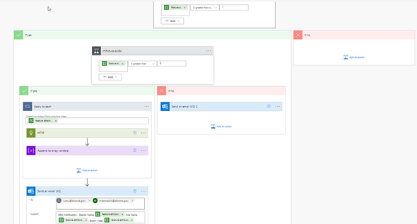

@IsmaelChiviteI am trying to use this guide for attaching two variables to an email (a photo and an attached .doc file) but I can't figure it out. I am essentially repeating the initialize/HTTP/append steps for each file, but I am getting errors. Any help?
Ursu_Lacramioara
Hi NeohLiMay and Hammers 21,
In the Survey 123 you will need an additional field that counts the pictures. You  can have this set up:
typename
label
imageImage1Take Pictures
integerImageCountImage Count
Image 1 is the question to take pictures.
ImageCount is to count these attachments. Field type as Integer,  and for Calculation field use this formula:
count-selected(${Image1})
 In the appearance field type" hidden".
Now in the MPA flow use a condition that calculates the pictures.
The condition is If ImageCount > 0 than add the rest of conditions from the user guide. I used the GET instead of POST for the HTTP trigger.

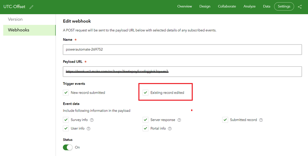

Does anyone know if this is possible to configure so that the email is sent when a feature is updated? Something like send an email with the attachments when a status is changed from "pending" to "approved?"
IsmaelChivite
Esri Notable Contributor
@ZachBodenner Go into the Survey123 website. Select your survey. Go into Settings-Webhooks. Enable the Existing record edited trigger.
ZachBodenner
MVP Regular Contributor
Thanks @IsmaelChivite ! Do I need to do anything in Power Automate after that? I still only get the "response submitted" trigger there.

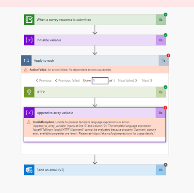

PS I'm also getting a similar error to many on here:
Unable to process template language expressions in action 'Append_to_array_variable' inputs at line '0' and column '0': 'The template language expression 'base64ToBinary(body('HTTP').$content)' cannot be evaluated because property '$content' cannot be selected. Array elements can only be selected using an integer index. Please see https://aka.ms/logicexpressions for usage details.'.
I followed @AmeWunderle 's advice to test step by step, using fresh test submissions, and still get the error.

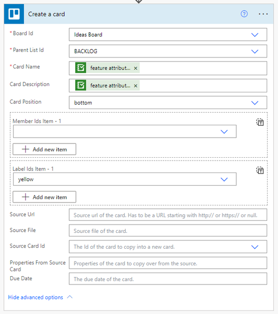

Hi @IsmaelChivite
I am using the connector to create a card in Trello with attachments (Images from Survey123). If the user attaches multiple images do you know I would set this up in Power Automate.
Current Setup:
I am currently loading the attachments into Onedrive as a Test which worked. Though it seems like an unnecessary task.
Any help would be awesome 🙂

I tried this walk through and get the same error a few people seem to be getting. I am using the multiline appearance for my image field within the survey, not sure if that will make a difference. The survey requires pictures so there will always be at least one. Did those of you who had the below error figure out a solution?
Any advise will be appreciated!
@IsmaelChivite @Ursu_Lacramioara @AmeWunderle1
(Unable to process template language expressions in action 'Append_to_array_variable' inputs at line '0' and column '0': 'The template language expression 'base64ToBinary (body('HTTP').$content)' cannot be evaluated because property '$content' cannot be selected. Array elements can only be selected using an integer index. Please see https://aka.ms/logicexpressions for usage details.'.)

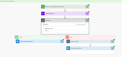

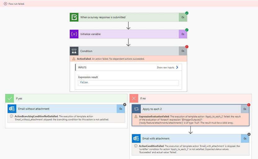

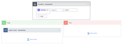

I have a survey where some submitters add attachments, others don’t. After the action "Initialize Variable" for potential attachments, I have a condition that reads:
“feature/attachments/attachments” is equal to “equals(triggerOutputs()?['body/feature/attachments/attachments'],null)”
Under the "If yes" option, I have a "Send an Email" action that is unsuccessful without attachments.  Under the "If no" option, I have a "Send an Email" action that is successful with attachments (after doing the necessarily steps for attachments as outlined in the article). I understand why the "Apply to Each" action fails, but do not understand why the "Email without attachment" action is skipped when there are no attachments (as seen below).
Perhaps this question is better suited elsewhere but any help is greatly appreciated.Flow_Example.jpg
abureaux
Hi @ThomasWrede
Your "Condition" step is what failed here. Everything below is automatically skipped because of this (Looks like something is wrong with your "Apply to each 2" logic as well, causing it to fail for some reason).
Assuming that the logic was successful: If your "Condition" was yes, then all the no steps would be skipped. Vise versa if "Condition" was no. This is perfectly normal:
For attachments, I personally do the logic step at the survey level, because it just seems far easier to me:
I provide a yes_no to even show the upload attachments option. And I use that question in the "Condition" step.
ThomasWrede
Thank you for your prompt response, @abureaux !
I can get the “Condition” and “Apply to Each” to work with attachments as seen here. My hope is that I can do the same without attachments.
I’m not sure I follow the suggestion on the logic at the survey level. Is something done in the xls form? Could you expand on that more? A couple of my flows are triggered when an “existing record is edited”, so that may complicate matters...
ThomasWrede
@JessicaRidout2
I used the "POST" method and "Feature Attachment URL" dynamic content url to have attachments successfully come through HTTP.  I used "base64ToBinary (body('HTTP').$content)" in the JSON expression as well.
abureaux
Hi @ThomasWrede
That looks perfect!
If you have gotten that far, I don't foresee you haveing any issues with the "without attachments" branch.
All I was referring to in my post is that I generally have a yes_no question in my surveys that contain optional attachments. Yes = Show and require an attachment. No = Hide attachments. In my Power Automate flows, I reference that yes_no question in the Condition step.

Is it possible to do this with the send an email notification, the send an email notification lacks the ability to "switch input to entire array". The send an email notification comes from Power automate, where send an email, comes from the user that is signed in. There are some draw backs to using the Send an email notification like only 100 emails in 24 hours, where send an email can send 900 in 60 seconds.
However I would prefer if my name wasn't in the from line, which is what would happen with "Send an email"
abureaux
I am successfully using "Send an Email (V2)" for all my flows:
RobertAnderson3
I'm, using the same as abureaux, In the advanced options you can set a "Send as" and I have mine set to our do_not_reply address, but you need permissions to send as that email address. As well it still shows up in my Sent Emails folder in Outlook, so not super ideal still.
abureaux
Sorry. I missed part of the question.
@RobertAnderson3 is correct, you can specify "From" in the Advanced Settings.
Another option is set up an account in your Connections:
In either case, being an email, you must specify an email as the source, but it doesn't have to be your email. I use a service account to send out all my automated emails. If you work for an organization, you can have your IT set up a dedicated email for that purpose (e.g., digital_stuff@yourcompany.com), and then use that for all of these emails. Hopefully that helps!
JaymieCroucher
Thanks for this article @IsmaelChivite
Export Nested Survey123 Images to SharePoint using MS Flow
I've seen lots of guidance around setting up a flow for sending images from a survey via email and to also uploading images to SharePoint (see below).
https://support.esri.com/en-us/knowledge-base/how-to-include-arcgis-survey123-photo-attachments-in-a...
https://community.esri.com/t5/arcgis-survey123-blog/survey123-tricks-of-the-trade-working-with/ba-p/...
Having followed both I've now successfully got a flow which lists all photo urls and has the ability to upload individual images to SharePoint (attached).
I now however have a problem around sending requests for multiple photos which are nested within a single question.
If I send individual requests (i.e. for surveys with only 1 Image) the flow runs successfully however if the nested survey question has 2 images associated I get a forbidden error as its sending 2 requests using the same token which individually work fine.
Are there any workarounds on delaying apply to each iterations or am I missing something with the token authorisation?
Any help or guidance much appreciated as this has been keeping me awake at night!
