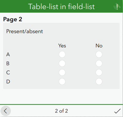

It seems like it's now possible to put table-list groups in field-lists in Connect, but it would be great if someone could verify.
Peren_Tuzkaya
I used the example table and it worked. Thank you very much.

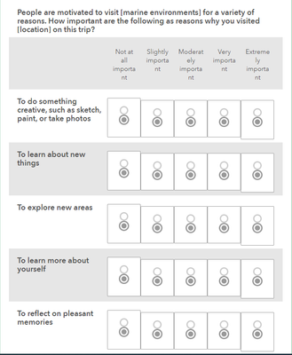

I've also attempted to create a survey using the Pages style with a table-list, single choice grid. This looks fine when previewing in Connect, but the formatting isn't displaying correctly on the web app (see image below). The formatting issue goes away when I remove the Pages style, but I prefer to be able to have multiple pages. Is there an easy solution for this?
