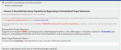

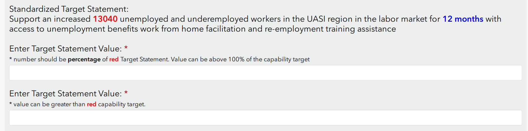

I have the following relevant statements set up below but when certain selections are made both answer options are available. I only want one based on the value of a previous statement. What am I doing wrong? I've selected Unemployment which is over 1000 but the question for under 1000 also appears.

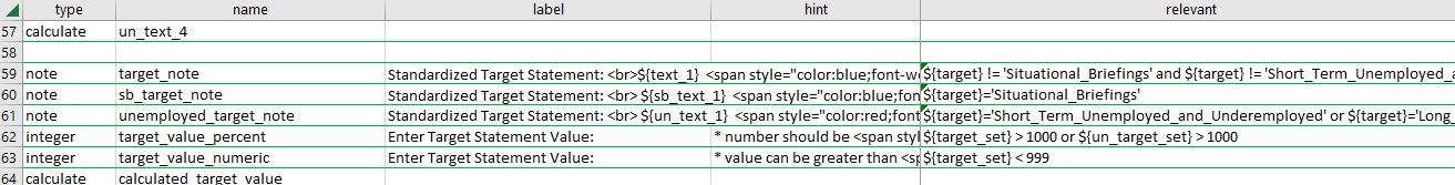

I've tried both:
${target_set} > 1000 or ${un_target_set} > 1000
(${target_set} > 1000) or (${un_target_set} > 1000)

type=integer name=target_value_percent relevant=${target_set} > 1000
type=integer name=target_value_numeric relevant=${target_set} < 999
type=integer name=un_target_value_percent relevant=${un_target_set} > 1000

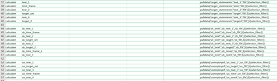

I do not see the fields target_set or un_target_set in your form at all.  Is it just not shown?  Can you post the whole form.  My guess would be those are note fields so they count as sting not int.  You can set the bind type column to int to fix that.
dwold
@DougBrowning those fields are calc fields from a csv file and then used to display a Standardized Target Statement note. Based on the value in the target statement, I want the user to enter in a either a value (<1000) or a percentage (> 1000)
 The action I am looking for behaves correctly when I do not have or ${un_target_set} > 1000 in the relevant field but those values (un_target_set) are all over 1000 so I want the user to enter in a percentage when they select unemployment from a previous question.

I think I got it to work...might not be the best/most efficient but I added ${un_target_set} < 1000 to the second statement and that question is gone when unemployment is selected because there are no values under 1000
