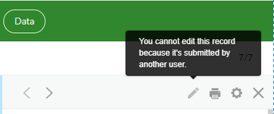

However, I'm hindered from adopting the Data UI by the fact that a user can not edit another user's record in this UI (except if you are the survey owner):

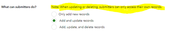

This, I think, relates to this setting in the Collaborate UI of the survey that can not be changed:

The Survey123 website does not allow users to edit other's data (aside form the survey owner).  As you've mentioned, there are other tools that can be configured for an editing/QA process, including Experience Builder.
