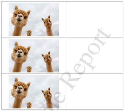

I have a feature report template that needs to display photos side-by-side. I have two columns where I want the photos to be positioned on each cell. The image question is not inside a repeat - just set to multiline.
I tried using getValue: "position", but it looks like it's only supported for questions inside a repeat. Is there any workaround that I could do to do the same?

Can you try the following to see if it meets your request?
1, insert a table in template (and I see you may have already done that);
2, place field names of image question and size in each cell of table like this:
${photo1 | size:460:0}
${photo2 | size:460:0}
${photo3 | size:460:0}
${photo4 | size:460:0}
${photo5 | size:460:0}
${photo6 | size:460:0}
maybe try from here and see what's missing for your result.
