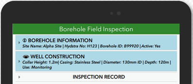

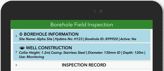

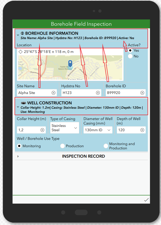

Since inspectors might not always need to see / edit the borehole information I decided to put it in it's own group and collapse the group by default. I had a brainwave though to display the details inside the group as part of the group header! This gives the inspector the advantage of seeing the information inside the group in a compact format without necessarily opening up the group.
Collapsed:
That makes things much neater!
The following label was used for the Borehole Information group:
<strong>🛈 BOREHOLE INFORMATION</strong><br>
<font size="-1"><i>Site Name: ${Location} | Hydstra No: ${Hydstra} | Borehole ID: ${DWS_Number} | Active: ${Active_yes}</font></i>
