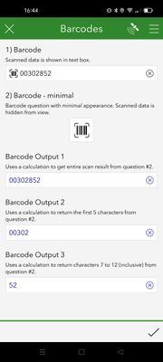

@mendoncaraissa Below is a screenshot when using the Barcodes sample survey in the field app 3.15.145
BarcodeBarcode
You are able to clear the barcode and rescan
Does this answer your question?
