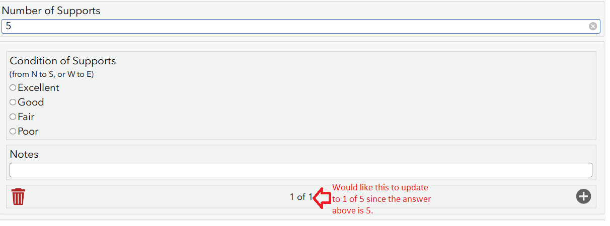

Hi,
I am wondering if there is a way to limit the number of repeats based on an answer to a previous question.  I have a question in my survey, Number of Supports, and want to limit the number of repeated relevant questions for each joint to the answer in Number of Supports.  Is there a way to do this in repeat_count?
Thank you in advanced for any help.
Steven

Did you try populating the repeat_count column in the XLSForm survey worksheet?
You can set its value to a number. For example  5, or ${yourIntegerQuestionName}
More info about repeat_count here: Repeats—Survey123 for ArcGIS | ArcGIS

SMW_GIS
Thank you Ismael.  I thought I tried that before and it didn't work, but I must have done something wrong.
