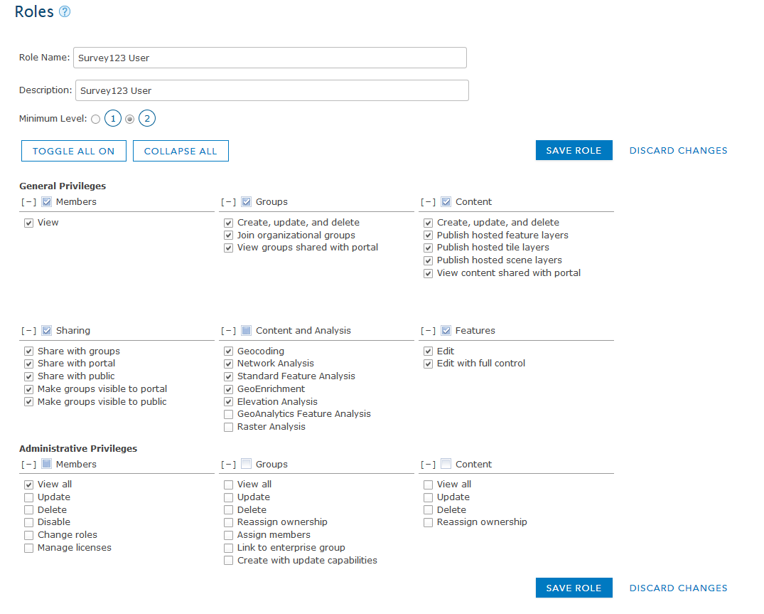

Triple checked the sharing and everything seems good (logged into Portal on iPad and viewed the details of the Feature Service as the problem user).  If the user is set to User or Publisher role they cannot submit a survey.  If set to Administator role they can submit.  I just created a custom role based on the Author role and tested and this works, see below for permissions set on that role.

Yes,  The permissions you display looks correct.  From your comment above, it sounds like you are using ArGIS Enterprise - can you provide more details or the setup of Enterprise and the survey (is it using a hosted feature service, a federated service? What are the settings of the service?)
