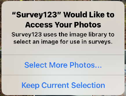

The first time after launching "select image from photos" he's encountering this warning:
It appears that a photo is already selected. After clearing the selection he can attach a photo but attempting to attach a second photo fails without an error and the warning above doesn't appear. I'm guessing this may be because the phone now has two photos selected and Survey123 is preventing the attachment of multiple photos.

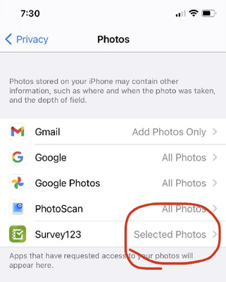

I found the error.
Privacy settings had been restricted to allow selected photos only. This setting is found under Settings -> Privacy -> Photos -> Survey123.
Changing that to all photos corrected the issue.
