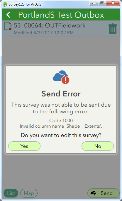

I have a survey that worked perfectly last week.  I published a web layer from ArcGIS Pro to ArcGIS Online.  I created a survey in Survey123 with the Inbox mode enabled.  In Survey123, I was able to load my data into the inbox.  But now when I try to edit it and load the existing data I get the error Code 1000 Invalid column name 'Shape__Extents'.
Any ideas of why this started happening and how to fix it?  I do not have any columns called Shape__Extents in my data, so this must be something Survey123 is creating?

Hi Sarah,
Can you provide a few more details?  Are these point features or line/polygon features?  Can you share the XLSForm?

They are point features.  Attached is my form

Thanks.  I don't see anything wrong in your form.  I'm thinking there might be something a little quirky with the feature service.  When you published it from Pro, did it have any data in it?  Can you go to the Item Details page and open up the URL for the service and see what the initial and full extents are listed as (as an example, http://services5.arcgis.com/jMCHJcLe13FaKCFB/arcgis/rest/services/survey123_97795a222f98497581a6ec71... of an extent for the whole world) ?  I'm wondering if this is the web equivalent of "not within feature class bounds" issue that occasionally appears in Desktop.

Yes, that's exactly what I was asking for.  Using the Full Extent, it looks like it's designed to cover the following area or so (the Full Extent provided essentially a lower left and upper right coordinate for a box):
Are the points being submitted within this box (the boundaries shown aren't exact, so if they're close to the line, they might be out)

Ah yes, some of the points are outside of the box.  I tried to change the extent of the feature service, but then then my survey wouldn't work at all anymore, so I started over.  I re-published my points in Pro.  It seems that ArcGIS Pro publishes an area that is a little smaller than the actual range of my points.  I'm not sure how to get Pro to publish a larger extent.  I made the extent of my service a little larger once it was published, and then created the survey.  It all seems to be working again.Thanks for your help!

I am getting the same error message, [{"code":1000,"description":"Invalid column name 'Shape__Extents'.","tableId":0}].
