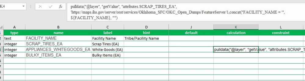

Hello, I am working in Survey123 Connect to pull data from an existing feature service when the user types in the facility name. I am using the following expression:
pulldata("@layer", "getValue", "attributes.SCRAP_TIRES_EA", 'https://maps.ihs.gov/server/rest/services/Oklahoma_SFC/OKC_Open_Dumps/FeatureServer/1,concat("FACILITY_NAME = '", ${FACILITY_NAME}, "'")
and getting the following error:
b'ODK Validate Error:\n>> XForm is invalid. See above errors. \norg.javarosa.xform.parse.XFormParseException: Invalid calculate for the bind attached to "${APPLIANCES_WHITEGOODS_EA}": couldn\t understand the expression starting at this point: ...CILITY_NAME , "\xcd\x8e\'")

pulldata will always return a string.  You can try wrapping it in int like int(pulldata()) .
But pulldata often has issues with being inside a function.  So if that does not work make a temp calculate field with hidden appearance with the pulldata calc.  Then in your integer field do int(tempfield).  You can set bind esri column to null on the temp field if you do not want it in the final schema.
Hope that all makes sense

No you have to wrap pulldata in int() or the 2 field trick.  Or leave as string if that is ok.
