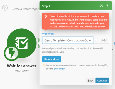

Unfortunately, this is where I ran into an issue. I am using the Integromat template called "Create a feature report and send it to email when a survey is submitted." I was able to complete the first step of the template (ie. create a connection between my Integromat account and my company's ArcOnline account. I was also able to generate a webhook for a survey on the account as shown in the picture below).

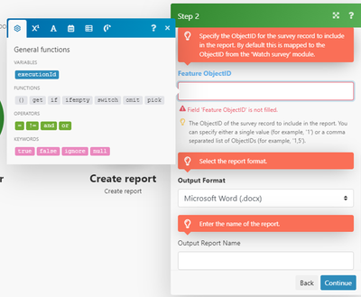

However, when I select "Feature ObjectID" and "Output Report Name", I run into an issue. When I click on either field box, I get a pop-up window (as shown below). However, this pop-up window does not show any of the questions in my survey.

I've seen something similar to this in the past and it was due to a configuration issue with the survey. Let's schedule a meeting to take a look into the issue and confirm if it's the same as the previous issue. If it is the configuration issue I am thinking of a few python scripts are needed to troubleshoot and resolve the issue. Please feel free to reach out to ZSutherby@esri.com and we can schedule a call to take a look and confirm if it's the same issue.

Sorry in delay in getting back to you. @ZacharySutherby  and I were able to find a work around solution after doing some troubleshooting. In your XLSForm for your survey, ensure that every "Label" field is filled in. The code that connects Integromat to the Survey123 form references this field. There is a coding bug that if this field is not filled in, it will not allow Integromat to connect to your Survey123 questions. Hopefully that helps you with your issue.
