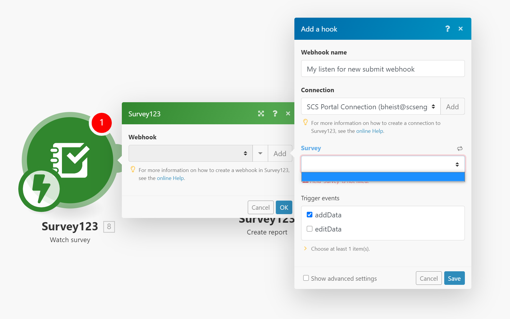

I'm trying to set up a webhook using Integromat that will send an email with a feature report after a survey has been submitted. I'm working with Portal, 10.8, in this case and have only worked with AGOL in the past. I have created a connection to my Portal and logged in successfully.
The issue I'm having is that I'm not seeing any of my surveys as selectable after adding my connection. The survey that I want to use has been created with Survey123 connect and published to our Portal. What am I missing or doing wrong that I'm not able to connect with any of my surveys after creating the connection? Shouldn't they be seen through my portal connection now?
JamesTedrick
Esri Esteemed Contributor
Hi @BHeist ,
That is correct- the author of the form must be the person configuring the webhook.
BHeist
So it seems you are only able to see a survey you've created and not one that has been shared with you. Does this sound correct?
JamesTedrick
Hi @BHeist ,
BHeist
Awesome, great to know!
