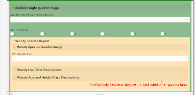

I tend to use groups with help images.

Neal_t_k
MVP Regular Contributor
Not sure on the single select question, but guidance hints can only be configured using Connect, but they do work in both the field app and the web app.
