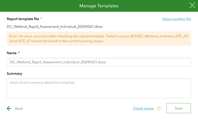

Hi! I've created a survey for what is basically an inspection workflow. I need to run a report on the inspection table that references the site identification information in the related parent table. I've attempted following the instructions linked here, but it appears like those are deprecated: https://community.esri.com/t5/arcgis-survey123-questions/created-survey123-from-feature-layer-with-r...
I receive a parsing error when I try the format of ${ParentLayer.FieldNameinParentLayer}
Is there a syntax fix to this? Thanks!

Thanks for your input! I've been trying out the dot notation. If my main feature is "DOEE_Wetland_Inventory" then {DOEE_Wetland_Inventory.SITE_ID} should theoretically work, right? I'm getting the same parsing error, so I feel like I'm doing something wrong still.
I've attached my xlsx and feature report template.

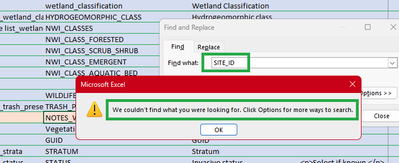

  • Your Feature Report question "${DOEE_Wetland_Inventory.SITE_ID}" will not work because "SITE_ID" doesn't exist in the XLSX **

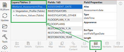

  • Check the Feature Layer name just to be safe. To do this: Go to the "Schema" tab > check the Feature Layer name under "Layers/Tables". In my case, assuming "SITE_ID" was in the XLSX, my dot notation would be something like "${Wetland_Assessment.SITE_ID}"

** EDIT: I am kind of making an assumption here... technically, you could have published this Feature Layer from ArcPro and then chose to omit "SITE_ID", or you could have published from Connect and then later deleted "SITE_ID" from the XLSX. In both of those cases, SITE_ID would actually exist in the Feature Layer
