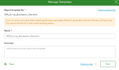

@ZhifangWang - Returning to this after a little bit: Is this workflow still valid?
The documentation hasn't changed, but I've gone to implement this precisely as I had it before but to no avail. I am working with the first example... I am running a report from a 1:1 child record, and trying to reference an attribute in the parent. I cannot seem to access any record in the parent layer.

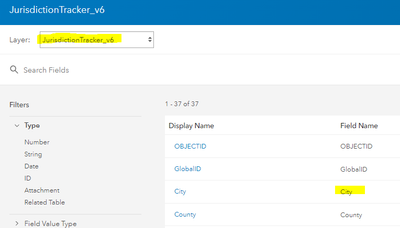

${City} is definitely a valid field in the parent layer....
Please let me know if anything has changed on Esri's end that would invalidate this workflow.

I cannot access the parent data using a feature report template run on the Services, it gives me the same error.  However, I was able to run a similar report on the Agencies, and access the programs and services.  It didn't work exactly, because I was unable to filter conditionally using any of the child features, only the parent.
