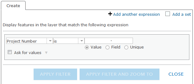

Are there plans to add in the ability to allow a user to select part of the filter that is being applied for the inbox query?
Meaning, that the survey form has a field/question that contains a  "Project Number" that is populated during the survey. The idea is that the user could enter a "Project Number" before refreshing the "Inbox" and then only have the surveys that are related to the user entered project number be returned to the inbox.
Something even more advanced would be to allow for the utilization of a field within the form to provide choices for the filter; which would be similar to the table filter that could be applied within the Web Map Viewer table.
JamesTedrick
Esri Esteemed Contributor
Hi Mike,
While not directly how you are describing, we are planning for some ways to have a more dynamic where statement at the user level to accomplish what I think you are wanting.  One of the approaches we are considering would involve making a URL parameter to set the query- this might accomplish the filtering on project you describe.

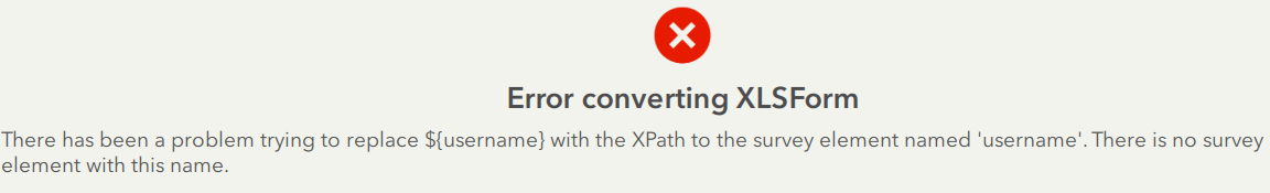

Ok one more question now, how do you download the related tables from repeats? From the documentation here I have tried both (query) and query = "Creator = ${username}". When I did (query) I did not get any errors, but the related table info still did not download. I re downloaded the survey in the survey123 app and refreshed the inbox several times, still did not show up. When I tried query = "Creator = ${username}" I get the following error is Survey123 connect.
JamesTedrick
Hi Alexis,
The blog post is for specifying the variables when setting the query for the parent form. At this point, we don't support variable insertion into the parameters column, so a repeat cannot be restricted to just the username while all parents are queried.  I've added an enhancement request to support variables in that column.
