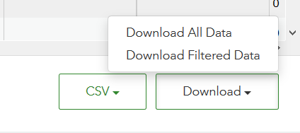

Download data with a date filter: From the Data tab you can download your survey data in shapefile, file geodatabase and CSV formats.  You can now use time filters to more selectively define the amount of data you want to download.  For example, you can now limit the downloaded features to those captured in the past week, month, or within two specific dates you define.

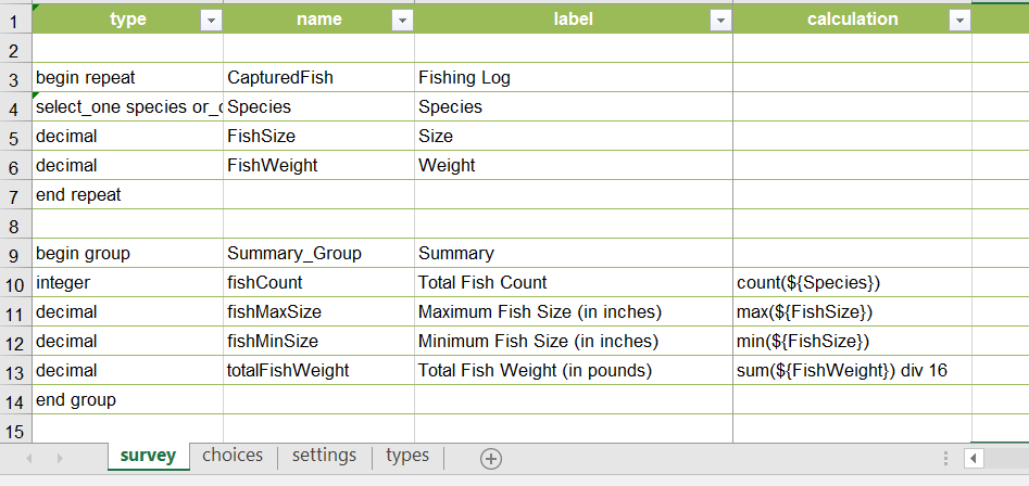

Repeat Aggregated Functions: A set of new functions are available so you can count, sum and get the maximum and minimum value within responses across a repeat. These functions are handy in many situations. For example, say you want to create a smart form to perform asset inspections and you want to detail defects and the estimated cost or repairs.  You can calculate the total cost of repairs by using the sum() function. You can also use the max() function to highlight the repair item that is the  most expensive.
Typically, the sum, count, max and min functions are used within the calculation column, but technically you can also use them to build constraint and relevant expressions.  For example, you can make a multiline text justification question relevant if the total cost of repairs exceeds a particular amount.
If you want to see these aggregation functions in action, you can give our Daily Fishing Log survey a try.  You can either try the survey in your web browser or if you happen have the Survey123 field app installed, from the Survey123 app.
If you are curious how these functions were used in the Daily Fish Survey log example, here is a screenshot of the XLSForm.
An XLSForm sample was also added to Survey123 Connect (Create New Survey-Samples) to illustrate the different repeat aggregation functions. Even the Daily Fishing Log survey is now  part of our  Community Samples.
