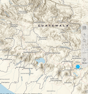

I want to use 'map' in 'inbox' of survey123 app so that my collegues find easily polygons or points to edit exigiting data
I submited 3 surveys for test but it does not show correct location of polygons in map tab of survey123 app( because I have polygons nearby the lake(in the center of map) but I only can see numbers located at my real location (the location that I submited records)
