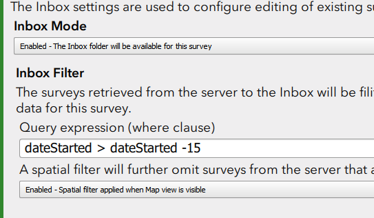

Is it possible for the inbox to show submitted forms only from the last 5 days? Perhaps through the inbox filter query expression which looks at a date field (example below).
My organization has over 3000 entries in survey123, and whenever a user refreshes their inbox, it takes an extremely long time to load.  They only need to edit the most recent submissions

This type of query should be possible, though it currently takes a little debugging to get the syntax correct.  In the query expression language, there are the keywords CURRENT_TIMESTAMP and CURRENT_DATE (Standardized SQL functions in ArcGIS Online—ArcGIS Online Help | ArcGIS ).  These are used by ArcGIS Online's filter to create a date-bound query.  For the example of the last 5 days, the query is:
requestDate BETWEEN CURRENT_TIMESTAMP - 5 AND CURRENT_TIMESTAMP

Thanks James! It worked. I assumed it was possible but just didn't know what the calls were.
