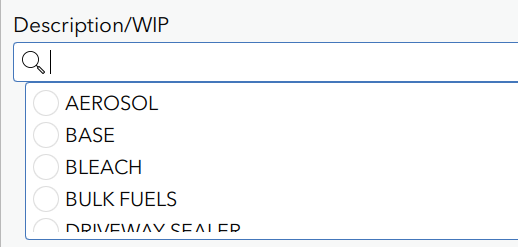

In Survey 123 Connect, I have a 'Description/WIP' dropdown question in which the user needs to first select:
After selecting the desired 'Description/WIP', there is another field ('Container Number') which contains a defined value based on the 'Description/WIP' selection using the following fomula:
if(${Description}='AEROSOL', 'abc', if(${Description}='PAINT CAN', 'xyz',''))
What I am trying to figure out is adding a sequential value after 'xyz'.  For example, the first time the 'Container Number' field would fill 'xyz1' the first time 'AEROSOL' is selected in the 'Description/WIP' field.  The next time that they use the survey and if they happen to select 'AEROSOL' again, the 'Container Number' would then fill 'xyz2'.
I have tried creating hidden integer fields for each 'Description/WIP' and have that auto increment using an if then statement without any success up to this point.
