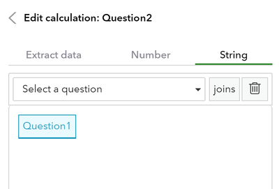

In the web designer, you can do this by using the "calculation" tool when editing your note question. You can select "String" and populate the text box with a previous answer. See my example below:
In survey123 Connect, you can use the expression "concat(${message})" in the "Calculate" column of your "note" field. Making sure to replace "message" with the correct field name.
Do let me know if this answers your question or if you would like me to clarify anything further.
