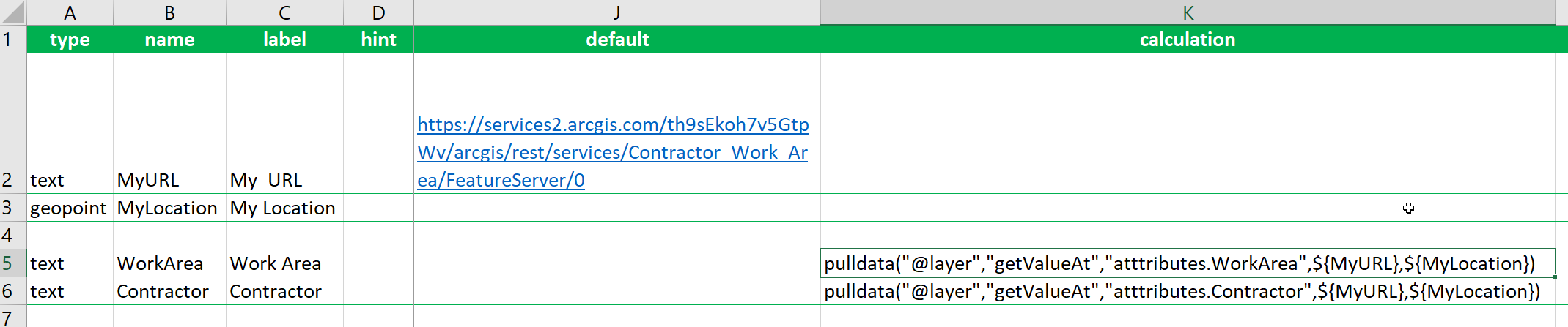

I am trying to do a simple point in polygon query in Survey123.
Here is my calculation:  pulldata("@layer","getValueAt","atttributes.WorkArea",${MyURL},${MyLocation}).
I have another survey where the syntax matches the above exactly and it works in that survey.
What am I doing wrong?
I am running version 3.18.
BarbaraWebster1
Hi @JimW,
It looks like you have an extra "t" in "attributes.WorkArea". Is the expession working for you if you remove that? If not, are there any error messages?

JimW
Thank you so much for catching that.  I am glad it was just a simple (and dumb) issue.
