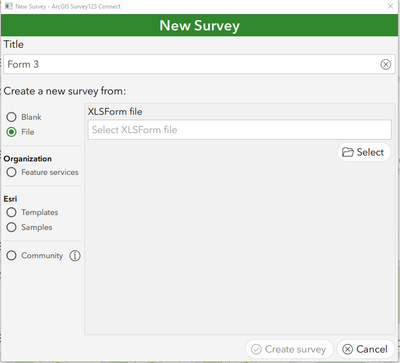

Once shared, all the outside organization would need to do is open Survey123 Connect, click 'New Survey', then select 'Create a new survey from: File'.  They would then navigate to the excel worksheet that you provided, and all they have to do from there is publish.
