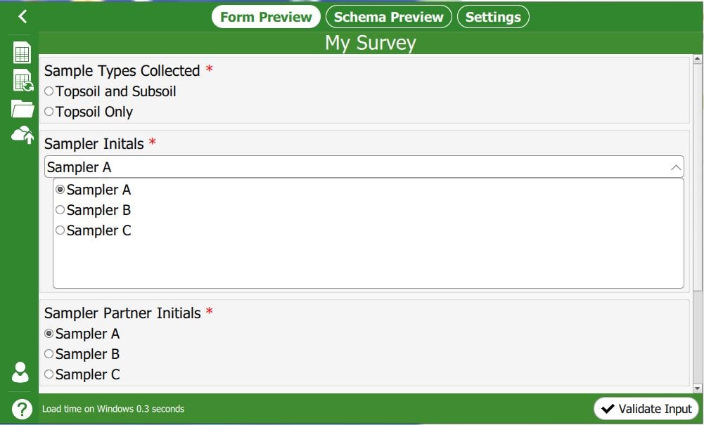

Hello,
I've got two 'select_one' questions in an XLSform and I do not want the answer selected from the first question to be available for the second.
For example if I select
Q1 Sampler Initials?  - Sampler A
1. Sampler A
2. Sampler B
3. Sampler C
Q2 Sampler Partner Initials? (Sampler A disappears because it was selected in Q1)
2. Sampler B
3. Sampler C
Whats the best way to remove the answer chosen in Q1 from Q2?

In case someone is stumbling over this question: You can solve this by put for question2 in the choice filter not(selected(${question1},opt)) and column opt in the choices sheet with the same values as in opt. Tested with select_multiple only but don't see why it shouldn't work for select_one questions.
