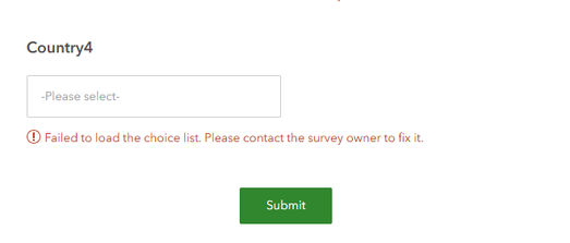

Your approach works great on Connect, the mobile app, and the desktop app. However, it fails to load the list on the web app (see attached image). Unfortunately, the app is primarily intended for use on the web.
Strangely enough, my current workflow behaves the exact opposite: it loads the full list on Connect, mobile, and desktop, but works as expected on the web app.
Thanks everyone for the helpful suggestions so far — I appreciate the support in resolving this issue!

@JoseBarrios1  I forgot,  there is some different syntax for web vs field app unfortunately and I don't know why.
web: concat("COUNTRY?url=https://services.arcgis.com/P3ePLMYs2RVChkJx/arcgis/rest/services/World_Countries/FeatureServer/0?orderByFields=FID DESC")
field app/connect: concat("COUNTRY?url=https://services.arcgis.com/P3ePLMYs2RVChkJx/arcgis/rest/services/World_Countries/FeatureServer/0/&orderByFields=FID DESC")
It really makes it difficult because to use this you have to chose 1 type of form.
