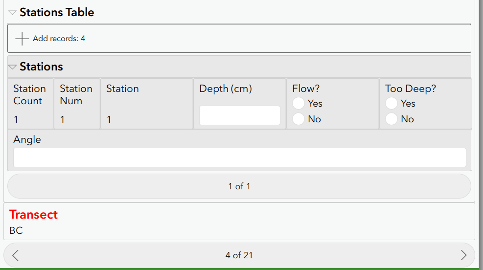

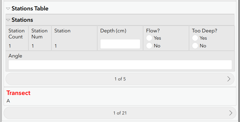

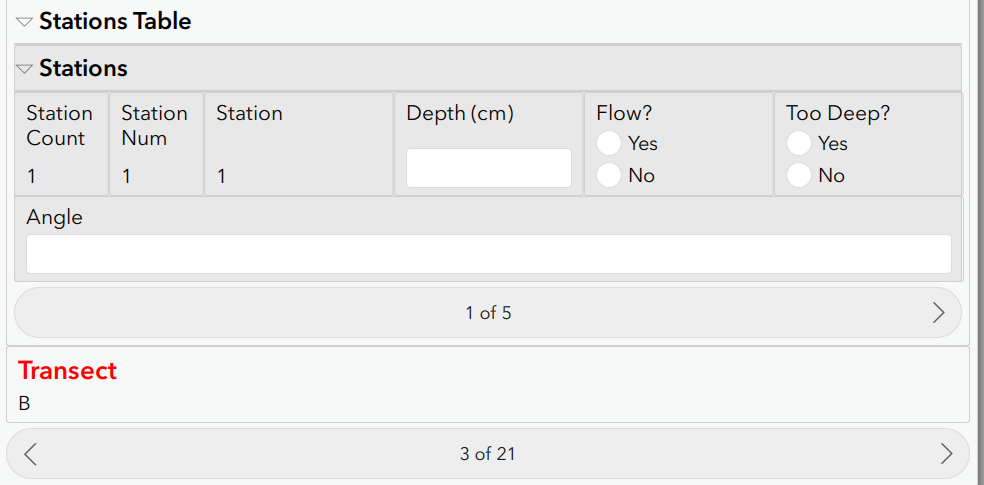

I have a form with a repeat inside of a repeat.  When I advance the outer repeat the inner repeat will not fire any calculations.  Everything goes to blank.
I have tried using once and such but no.
First outer repeat
StationCount is calc of 1
StationNum is calc of once(count(${StationCount}))

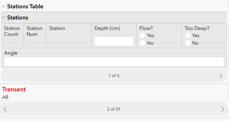

Second outer repeat all the 1s are blank.

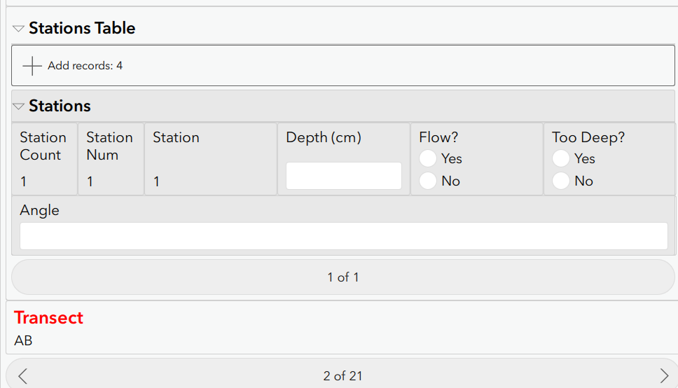

I then added a if to try and force it to calc.  That works but then adds this Add 4 records box.  But it only does that on every other outer repeat.
StationCount now if(${ThalwegTransect}='A',1,1)
On 2
On 3 the 4 thing goes away
On the 4th the box comes back again.
Ideas to fix this so it fires correctly all the time without the Add records thing?
