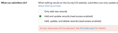

You need to use a View to safety hide the fields you don't want people to see.
The S123 website also has a link:
