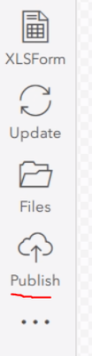

But anyway, when you open the survey in Connect now, do you have an option to view the XLSForm? If so, that's how you'd add the new fields (new rows in the excel sheet). And then you'd click Publish as I mentioned before and it would update with the changes.
