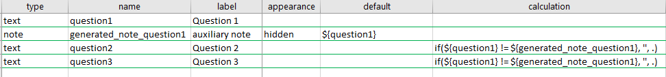

When editing a previous survey submission, I wan't to clear the responses for questions 2, 3 and 4 if the answer to question 1 is changed.
To achieve this, I tried to created a hidden note that would take the value from question 1 with the default parameter and then calculated if the value from question 1 is changed by comparison. Something like:
Unfortunately, this gives me a "Dependency cycles" error!
Any suggestions on how to achieve this?
LaurenceTait
You'll need to use the "once" function. That stores the first answer given to a question. You can then use that as your comparison point without running into dependency errors.
Example attached below.
CarlosSousaFerreira
It seemed a great workaround, but it still gives me a "Dependency cycles" error! 😞
LaurenceTait
That's weird. It works perfectly well for me.
Are you saying that when you open the .xlsx form i uploaded, you are getting a dependency cycle error in Connect. If so there's almost certainly a problem with your version of connect. Try reinstalling.
