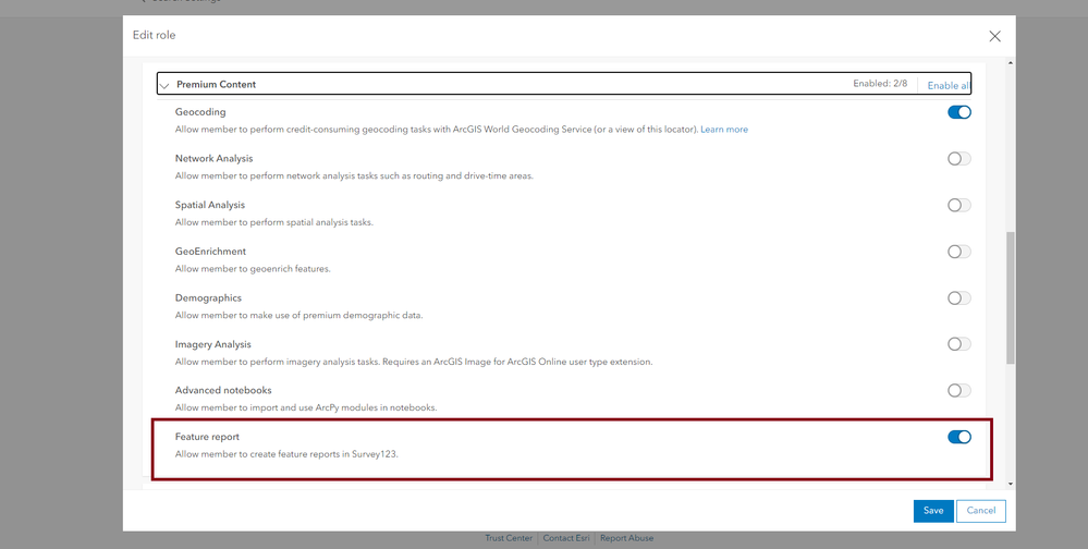

It is likely that the users have not been granted privileges to request Survey123 reports. Check the role of the user. Under the Premium Content section, make sure that Feature report is enabled as shown below.
