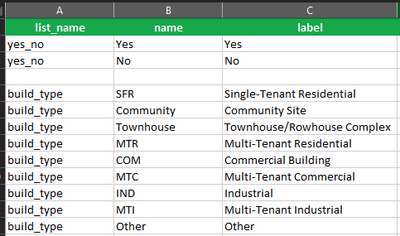

You can use not(). E.g.,
count-selected(${REAPMinimum})>0 and not(selected(${REAPMinimum}, 'The date(s) rain is predicted to occur, and predicted chance of rain'))
Is that actually what appears in your name column? That looks like a label. When writing these, you always reference the name column. E.g., I'd write selected(${ptype},'SFR') and not selected(${ptype},'Single-Tenant Residential')
