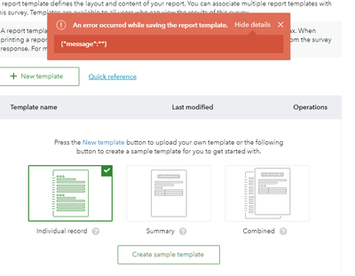

Hi,
Here we go again...
I don't want to polemicise but with Survey123 happen too often that I have to try to find a way to solve an issue and the error messages never help.
So, This time I am simply trying to "create sample template" and I get this error message.. couldn't find this error and it doesn't mean anything.
"An error occurred while saving the report template. Hide details
{"message":""} "
Any suggestions?
Thank you
DeonLengton
Hi Mark
Did you create the survey with Connect? Can you share it's Excel design file? Maybe there's a reserve keyword lurking somewhere.
AdamGaudet
I had this exact same problem. The issue was that an attribute had a value of 'esriFieldTypeInteger' for "bind::esri:fieldType". (The attribute was a string selected from a list.) I removed 'esriFieldTypeInteger' and it fixed the problem.
