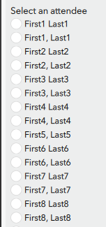

However, this returns the entire attendance list instead of just those that match the parentglobalid .
The list should only show First1, Last1; First2, Last2; etc.
