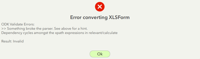

I am creating a form in survey123 that records plant species along different transects. It would speed up productivity a lot if the survey could default to the last species selected. Has anyone set up a survey like this before? I am trying to capture the last species collect in a text field outside the repeat, but I am getting the error below. I am attaching the survey below.

Are you trying to do something like a Same as last button?  If so then no can't do it if the size of the value varies.  I created a page with a default values setup then it asks you Use Defaults?  Best I could do.  I posted on this but cannot find it in the new system.

indexed repeat will not work when trying to bring it into the next repeat to a field with the same name.  It can only show it in a different field.  This more or less makes the function useless for most uses.
The only way I have ever got same as last to go into the same field is using javascript - but my repeat is too big (at 60 fields) and blows up with a memory issue.

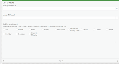

For the defaults page its simple - just a if to use or do not use.
if(${UseDefaults}='Yes',${CollectionNumberTopDefault},'')
 Hope that helps.
