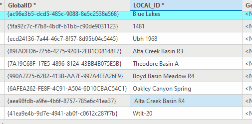

Anyone else notice that in Pro the header had GloabId all caps.
But in the Detail in ParentGlobalID it is lower case
Not sure if it is just Pro since I have seen this a few times.
thanks

Just to note, I have services with lowercase GlobalIDs in both parent and child.  As I've mentioned elsewhere, case shouldn't matter as the 'letters' are hexadecimal digits (i.e., a/A = 10; b/b = 11; etc.).  If you see this causing an issue, I'd suggest filing a support ticket on this.

We looked at something similar over on https://community.esri.com/message/888567-globalid-inconsistent-display
Garrett Seay‌ indicated that he tested on Pro 2.4 and didn't see what you were reporting there.  Doug Browning‌ that other thread is tagged with 2.4.1.  Is that what version of Pro you're on?
When I tested (and I imagine when Garrett did) I was just creating globalIDs in Pro itself.  Is the data where you're seeing this created in Pro or is it always coming from Survey123?

Just updated to 2.4.1 and it still is doing it.  Data is always from 123.

I confirmed that my coworkers computer does not seem to do it.  Is there something I can do to reset it?

Got a gif today of Pro doing it even when editing a different field.
