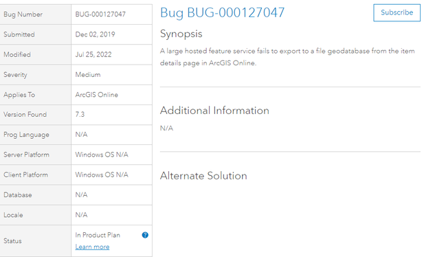

Note I am currently working on a ticket with Esri now.  For the last few years once a service hits 10GB the script starts failing.
DougBrowning
MVP Esteemed Contributor
Sorry just got the bug #BUG-000127047 back.  Been 3 years but looks like it is in plan now at least?
