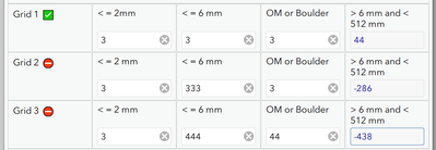

Two ways I use.  One is a note using a red font and a relevant.
The other is using emojis.  See my post on this here. https://community.esri.com/t5/arcgis-survey123-documents/how-to-simulate-instant-data-checking-using...
Hope that helps.
Hope that helps.

DougBrowning
MVP Esteemed Contributor
You need 1 field that determines what the emoji will be.  The &#.... part is the HTML for the emoji.  You can bind esri type to null so that the field is not created in the service.
if(value is good, "✅", "⛔")
Then you can use this field in a label.
Reach Length Surveyed (m) ${ReachLengthCheck}
The label will display HTML so it sees the emoji code and shows it to the user.
Not sure what else I can say.
If you want an actual message you could do that in line also.  Or even both with maybe a skull emoji?
if(value is < 10, "&#128128;Warning oxygen level is dangerous", "&#9940;")
Hope that helps
