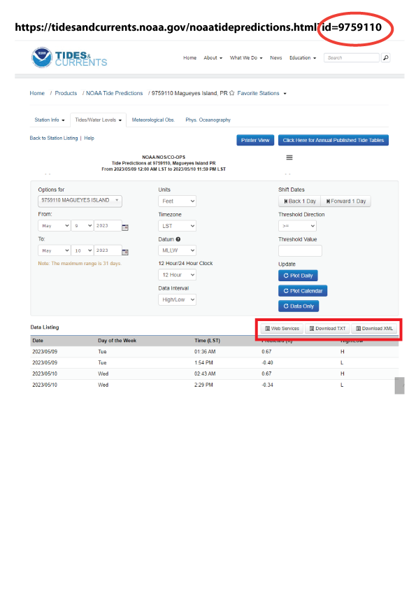

Thanks you so much for taking time from your busy schedule to answer my question!. It work great, with the limitation that  the the API attributes does not have the  tide information and it is probably using a regional sensor to provide a local parameter.  I found a NOAA site that provide direct links to their weather stations but I'm not sure how to target those specific areas. Looking at http request, it seems that is using the station ID to pull the local weather parameter. Here the info provided by the closest station to the research area: https://tidesandcurrents.noaa.gov/stationhome.html?id=9759110#obs.  and the link for their web services are: https://tidesandcurrents.noaa.gov/gis-data-portal/
and the stations id: https://opendap.co-ops.nos.noaa.gov/stations/index.jsp
There are several stations around the research area (see attached pic) , I was wondering if I should change the workflow to pull a list a known station ID's and then use that ID to pull the weather parameters for that station so I can get accurate local weather parameters. Thanks once again for your providing your expertise and support! I know that many folks are also looking on how to accomplish this and I will share the final form template  in the  Connect community for the benefit of others! Thanks once again for your support! It is amazing what we can do with Survey123, awesome product!

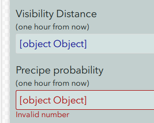

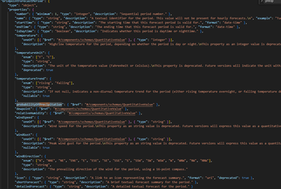

@IsmaelChivite To provide some more information on my above post, I've been playing around with the API pull to try to get some additional data, and while I think I'm on the right track, it seems like something isn't working quite right. So as an example, I'm trying to get some precipitation probability information from the NOAA API. I opened it up and located what I think are the other property data that you pulled in your proof of concept:
Then I tried to plug it into the form using the same syntax, both in a decimal or a text question (for testing purposes):
and I get this:
I've tried some of the other properties in that group, but the only one that I successfully got to populate was the temperature unit.
Anything you notice that I might be missing?
