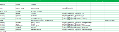

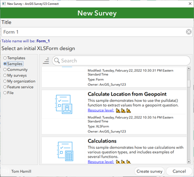

@bryandhughes, I'm not sure how to configure this in web designer, but in S123 Connect, there's a Sample form called 'Calculate Location from Geopoint' that shows this quite well.

@bryandhughes, by any chance did you try to implement that with Survey123 Connect to obtain Z-Values from the tablet?

AaronPDXPaul
I am trying to get the Sample Calculate Location from Geopoint. The Altitude field is not pulling data. Same when I try on my service. Has this feature broke, or no longer can get z value?
