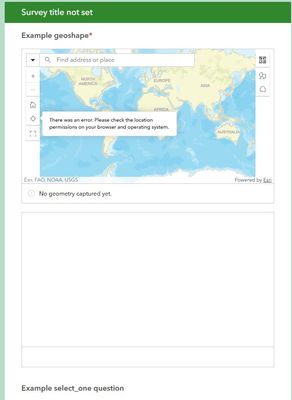

Hello,
I recently republished a survey with some small changes and noticed this issue with the geoshape field - it seems to be creating a duplicate of the map window below it as a blank box. I am using Survey123 Connect's Standard Template, last modified 9/16/25.
Below is an image of a dummy survey I made with just a geoshape question without any formatting except being required and a second example question from the template retained. I've uploaded the XLS Form for you to test.
Any idea what I can do to remove this box? It is showing up in both Chrome and Edge browsers.
Thanks for your thoughts!! 
