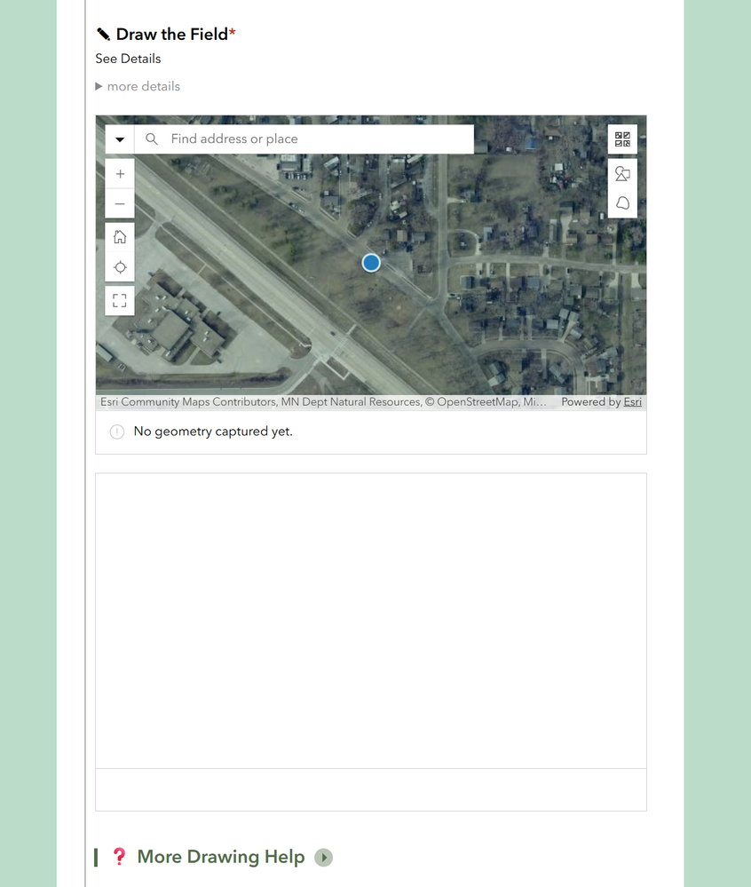

I recently republished a survey with some small changes and noticed this issue with the geoshape field - it seems to be creating a duplicate of the map window below it as a blank box. I am using Survey123 Connect's Standard Template, last modified 9/16/25.
Below is an image of a dummy survey I made with just a geoshape question without any formatting except being required and a second example question from the template retained. I've uploaded the XLS Form for you to test.
Any idea what I can do to remove this box? It is showing up in both Chrome and Edge browsers.
Thanks for your thoughts!! 

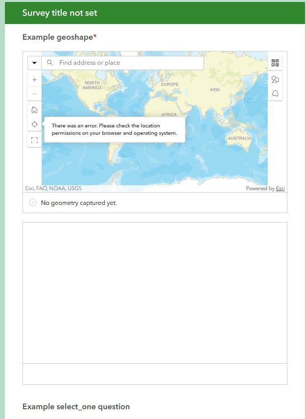

This is a bug unfortunately. I raised it with ESRI and they have escalated to high. BUG-000183824 if you need to quote it.
If you put ?version=latest on the end of your survey URL it will vanish. It seems this is an issue where 3.25 version of survey123 is fine, but 3.24 (the current live version) is broken.

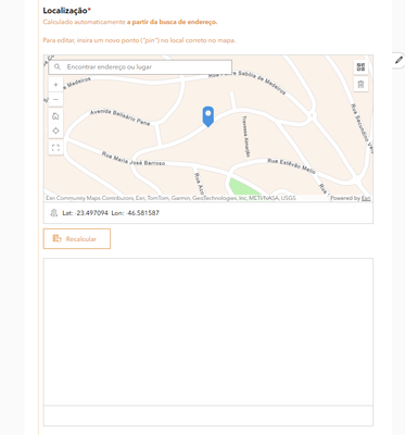

I also started experiencing this in a geopoint question that's been running on the web for quite some time, republished with Connect version 3.24.31 today (I'm not sure if it started today as I don't always open the form, but it's been less than a week for sure).

Teresa_Blader
Me too!
