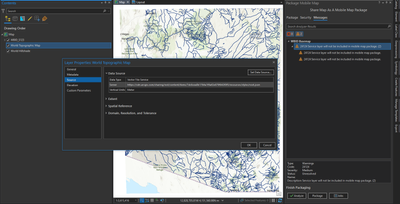

I am trying to have an offline basemap with 2 layers of our data. When I do a mobile map package, it only shows my layers and no basemap. How do I get both in there? I have put it in the media folder of Connect and also tried to link the survey to published layers (but that one won't go offline).

djcrouse
It still does not let it go with the layers. I even tried saving them as layer packages.

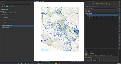

djcrouse
I saved them as map packages and added them in (removed the regular basemap layers). They are still using a service though.

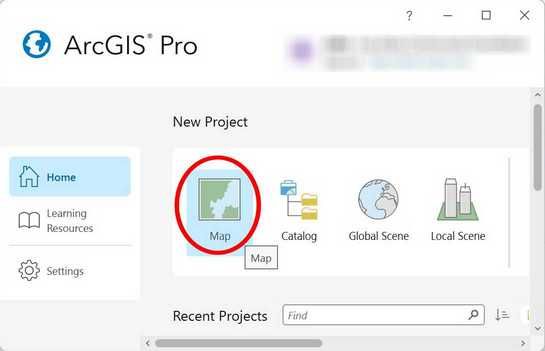

I like to use one of Esri's vector tile layers to create an offline map for use in Survey123. The resulting map.mmpk file is much smaller than files created from some other sources, so downloading it to users takes less time. Here's what I do:

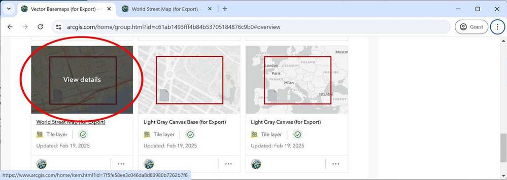

Search the ArcGIS website for Vector Basemaps (for Export). Click View Details adjacent to the group by Esri Inc.
Click View Details in the map of your choice.

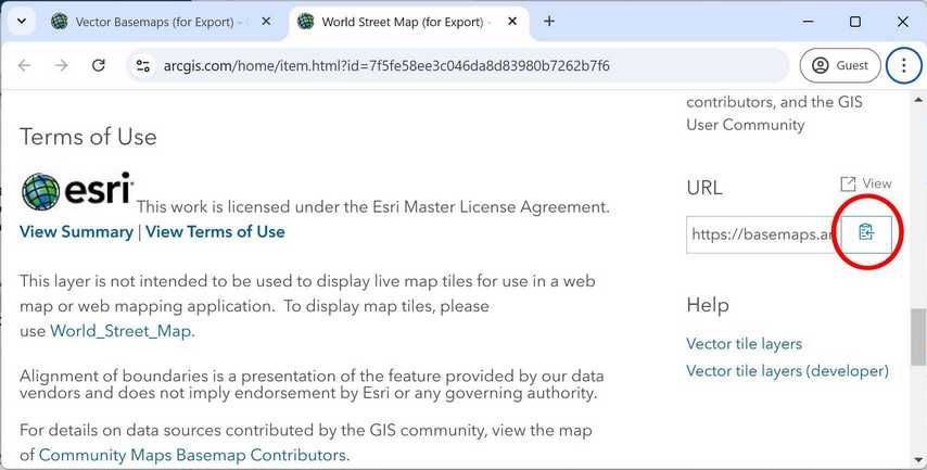

Scroll down and copy the URL of this map.

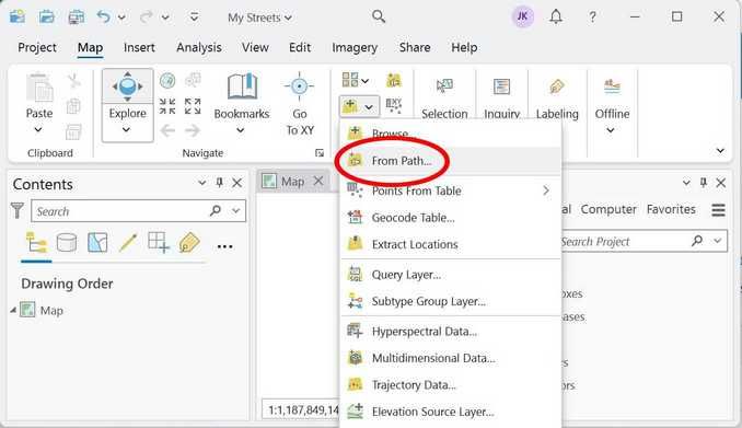

Start ArgGIS Pro and create a new map.

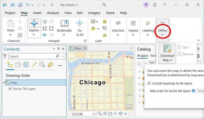

Remove the basemap and add Esri's vector tile layer from its URL.
Pan and zoom to the area of the map you want to take offline. In the Map ribbon, click "Offline > Download Map" and tick the box "Include basemap and tile layers."

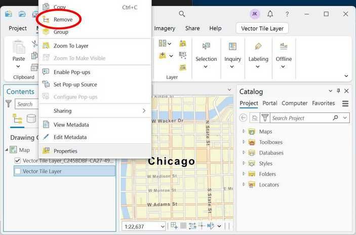

This will take some time. Eventually, a new layer will appear in your map. Next, remove Esri's layer.
In the Share ribbon, click "Mobile Map". In the "Package Mobile Map" pane, tick "Save package to file" and "Current display extent", enter the name of your new mmpk file and then click "Package".
