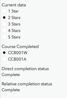

Is it possible to have an if statement that takes no action when returned false?
Example using a statement I am using currently:
if(${Course_Completed}= 'CC8001W' , 'Complete', 'Incomplete')
I would like to remove the 'Incomplete' part, like this:
if(${Course_Completed}= 'CC8001W' , 'Complete')
So that the only changes to the data will be to input Complete.
Or in other words, if current data exists, do not change it.
Any help?

Would you mind helping me put together the expression? I don't quite have the skills for that yet.
LaurenceTait
I'm not entirely clear what you want to do.
If you literally just want to return an empty value directly, you can simply use the following:
if(${Course_Completed}= 'CC8001W' , 'Complete','')
If you want to maintain current data from another field unless the completion status is a certain value, then you need to use that field as an option in the if statement:
if(${Course_Completed}= 'CC8001W' , 'Complete',${current_data})
If you could explain what you are actually trying to achieve and why, it would be easier to work out the solution.
Hammers211
Thank you for the reply, this is helpful.
I am using the edit mode in this case and often there will already be a value of "Complete" in the "CC8001W_Complete" field. In such cases, I do not want to modify that data, I would like it left as is. I think what you are suggesting with using ${current_data}) is close to what I need, however I can't get it to work. Is ${current_data}) an actual string I can input? Or by current_data are you referring to another specific field?
