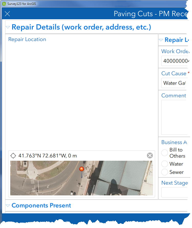

I am experiencing an issue that i can't seem to figure out.  I have created a survey using the theme-grid style.  On this survey is a geopoint and further down the form is another geopoint in a repeat.  Here is how the first geopoint displays in my survey:

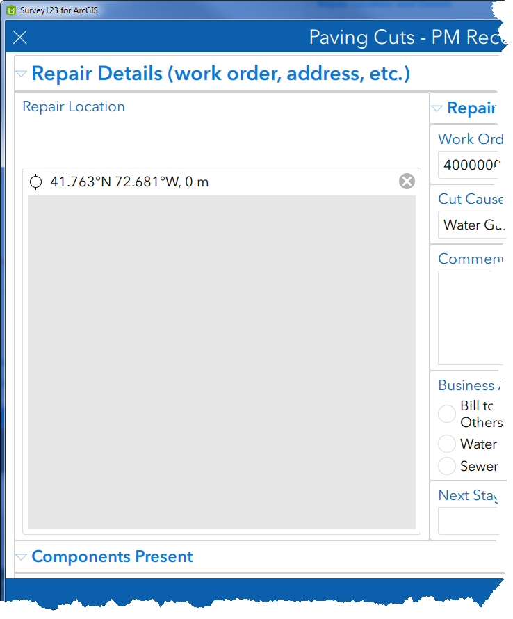

There is a lot of empty space so I set the height of the question to height=20 in the body::esri:style column.  This is the result:
I can't see the map. I get a gray box that appears to be the height that I set.  If I click on the map and the click a new location, the map appears in my survey.

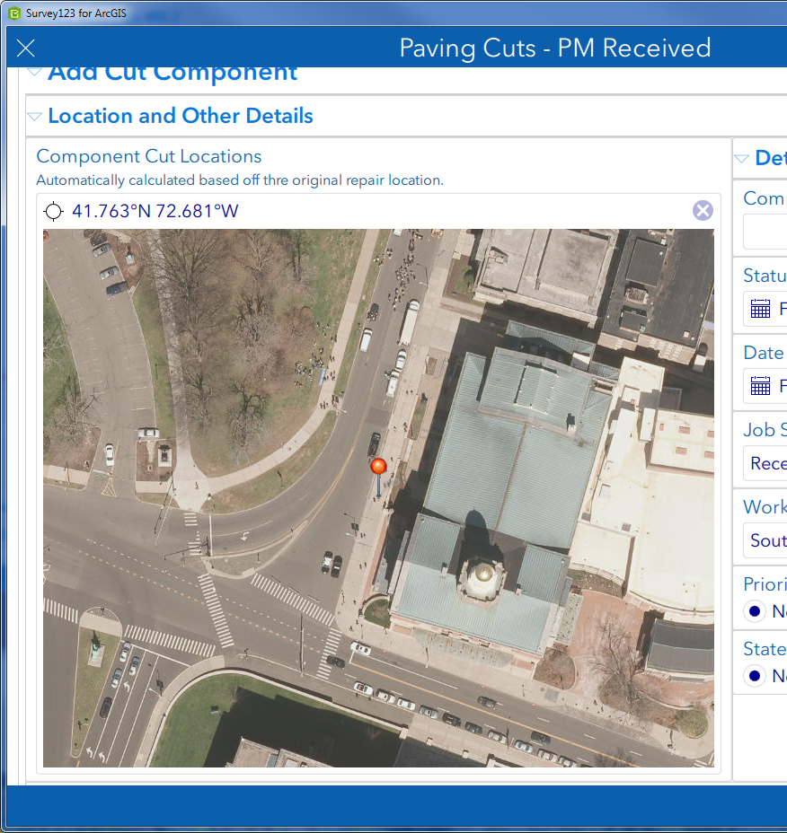

Further down in my survey, I have another geopoint in a repeat.  The geopoint location is set based on the location in the first geopoint question.  In the XLSForm, the geopoint question is configured exactly the same but displays the map:
Why does the first geopoint question not display correctly with a height set but the second does?  Thanks.
