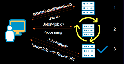

We have our Report REST API documented in our developer documentation. What you would need to do is send a createReport/submitJob POST request with the required parameters. The createReport task is going to return a Job ID. You would then need to periodically (every 15s or so) send a /jobs/<jobId> GET request based on the jobStatus. If it's still executing reissue the request, if it completed you can then extract the report(s) from the resultFiles property located in the resultInfo.
Here's a little graphic that demonstrates the workflow:
As a side note (I'm not sure how you are planning on implementing your workflow) we have a number of methods available in the ArcGIS API for Python that can be used to automate the generation of Survey123 Reports. Please see this sample Jupyter Notebook for reference.
