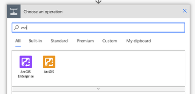

3.
Add a new step. Search for "Esri" and click on your proper environment (Enterprise = Purple and AGO = Orange).
More details on these connectors is here.

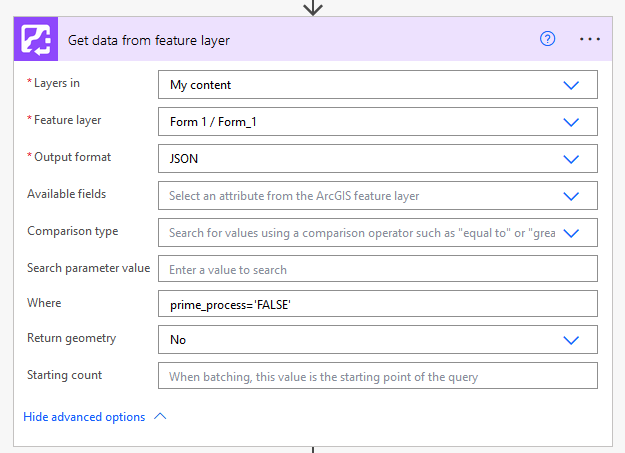

4.
Select "Get data from feature layer". Configure the three required steps by pointing to the survey you are building for, and choose JSON as the output.
The only other important item here is the Where clause (e.g., prime_process = 'FALSE'). Without that, you won't process the proper item(s). I am using my newly created "control field" referenced in Step 1.
"Return geometry" is optional and you can probably leave that as "Yes".
More details on connector limitations is here (e.g., Return Geometry).

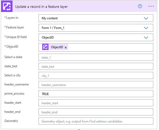

5.
Add "Update a record in a feature layer". The first two fields are again the survey you are building for.
The third field should be "ObjectID". Then, in the fourth field, select your ObjectID from dynamic content. This will automatically nest your step in an "Apply to each"... That makes sense, because even if there is only one item in your Feature Layer, the operation is an array.
Lastly, find your "control field" and toggle it to indicate the item was processed. (e.g., prime_process = TRUE)

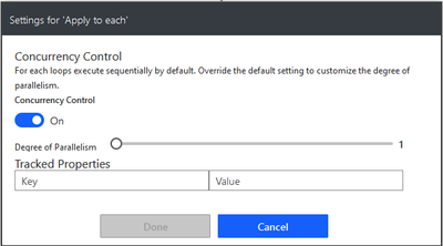

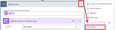

6.
Before continuing, take a step back and select the Settings for your new "Apply to each".
Then turn on "Concurrency Control" and set it to "1"
This ensure that we don't double-process an item by only handling one at a time.

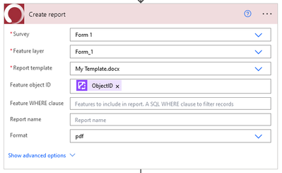

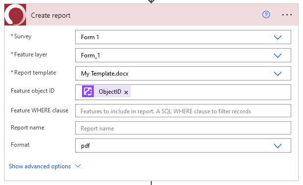

7.
Add "Create report", point it to the same survey you are building for, and configure as necessary.

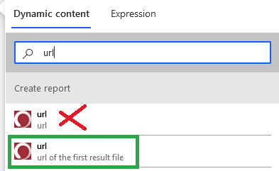

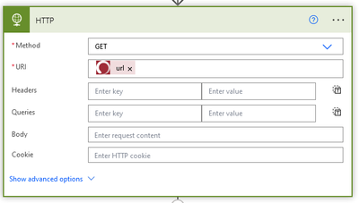

Add "HTTP". There are only two things to set here:
When adding the "url" from dynamic content, be sure you grab the "url of the first result file", as indicated below.

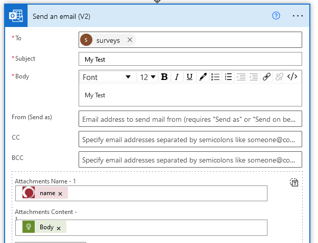

Add "Send an email" (or whatever steps you want really. This is just an example).
The only really important thing I wanted to showcase here is the attachment. For the name, there will be two options, just like "url". Be sure to choose "name of the first result file". For the Attachment Content, use your HTTP's body.

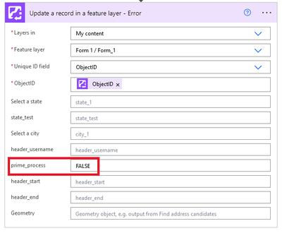

10.

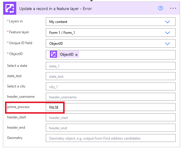

And lastly, add a second "Update a record in a feature layer".
Configure it the same as the first, but set the "control field" back to FALSE. This is our (super basic) error handler.
Then, click on the ellipses (...) and select "Configure run after" and choose "has failed" and "is skipped". Then, hit "Done".

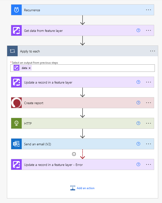

In the end, I got this:
Very simplified flow. But it's at least a starting point. I'll be building out my process form here to add in a bunch more steps and redundancy.

Thank you so much for putting these guides together @abureaux !
I'm going to have to update all of my When a survey response is submitted triggers for sure, I haven't prioritized it yet because the webhooks that create reports, the user will see it hasn't been created and just submit it again, a nuisance but manageable.
I know it's the basic first pass, but a suggestion I might include is putting the actions Update record (1), Create report, HTTP, Send Email in a Scope, and then having the error catching Update record (2) set as a run after fail/skip on the Scope, just in case an earlier action than the email fails.

Oh, I totally agree! I thought to myself... these should really be in a scope. But I was lazy and convinced myself this was just a "proof of concept". (The "Skipped" part of Run After kind of works in this case, but it isn't a good practice).

Haha fair enough! I had a feeling you'd have thought about it but went basic for the proof of concept. I didn't realize the Skipped would trigger in that case, I thought a failure would just end things.
