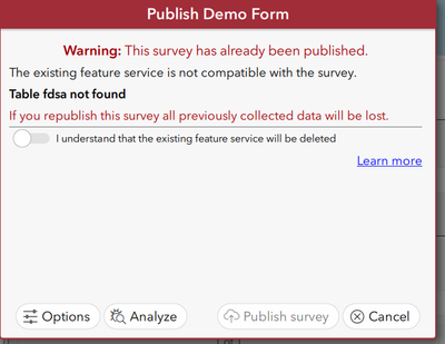

Did you make any large changes to the survey? E.g., did you see a message similar to this one?
If so, not only does this reset collected data in the Feature Layer, this also resets security permissions. Go to the Surveys Site (or Portal - I just prefer the Surveys Site for this particular task) and check that the survey is shared properly.
